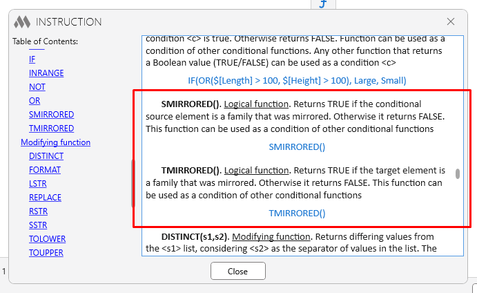

Not, it is not possible. If you need some API property - write us and we try to add function for it.
"Mirrorerd" already added
